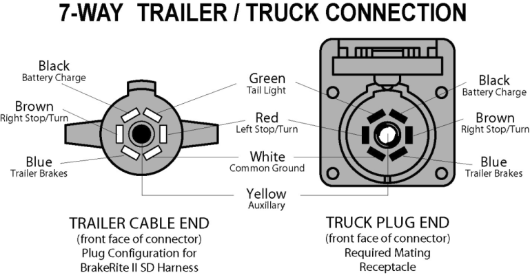

Think I found a diagram.. blue is ground and power is red.. is that correct ?View attachment 536074
Careful, the color callouts are for the typical wiring harness that comes with trailer items like a light kit. I don't know what color the wires are in the RAM harness that feeds the 7-pin socket.
