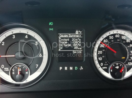

Actually paid attention this morning driving to work in snow with 4WD engaged. Tranny stayed around 110 once warmed up.
