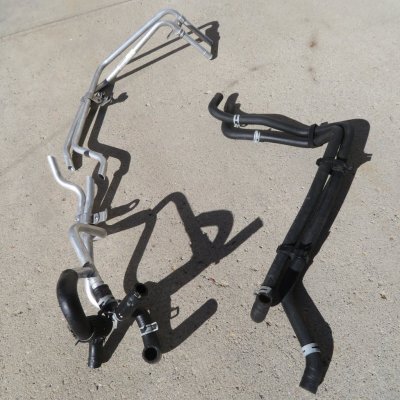

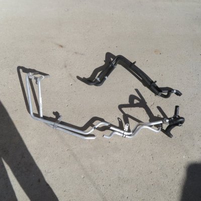

3-way valve hose routing:
1. Top w/p nipple to end of top metal tee line for trans heat exchanger
2. Metal tee line "tee" to heater core bottom line
3. Metal w/p line to front of 3-way valve
4. Rear of 3-way valve to top heater core line
5. Side of 3-way valve to bottom metal line for trans heat exchanger

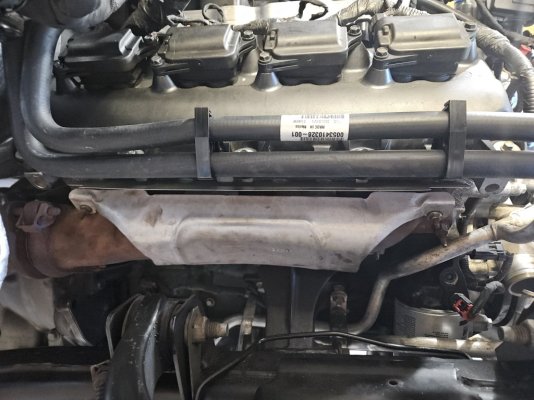

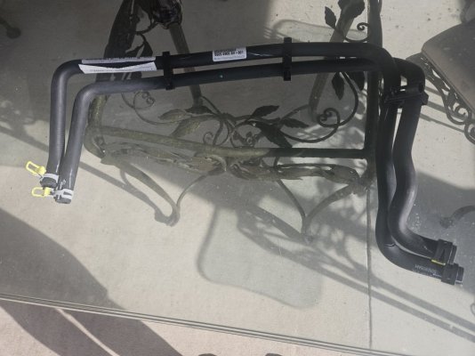

New OE heater hose set w/o 3-way valve.
Part # 55056906AH
New heater hose routing:
1. Top w/p nipple to bottom heater core line
2. Metal w/p line to top heater core line

Just to add to @EdGs post,these are the 3 way valve hoses removed. With the transmission in place,you have to cut them to remove them
