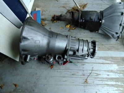

i have a trans that has never been in a truck .... its for a 97 4X4. ... had it built and hit a deer going to the shop to have it put in. all HD guts so it could take a 200 shot of NOS. still has the tags on it. ..... 1700 .... im in it 3k

swap the tail shaft and the one i have will work for ya .....
