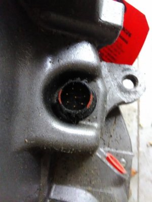

Will only 96-99 transmission work in a 98? Or will up to an 02 work?

chech the plug .... if its the same ya be ok. .... dose yours look like this??
It doesn't really matter what year 727 46re rh 518 or whatever you can bult up will work just use compatible components converter pressure switch rostercolmb
904 -500-42r or-727-518-46-RH RE use whatever one you want
