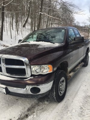

Looking for some advice. My 2004 ram 2500 5.7 hemi automatic is having shifting issues it has 84000 miles and is acting like the transmission is slipping . I was diving 55mph with the cruise on and the truck ****** and then the check engine light came on directly. I just had it in the shop for the same thing and they replaced the shift Solenoid I drove it about 50 miles and the same this is going on any thoughts of why it’s happening again and what might cause this?
