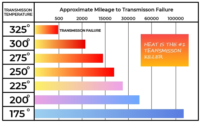

Below is a trans temp chart that I saw way back when Mopar first started using ATF 4, I'm glad to see charts like this are still around being few people have any idea of what heat will do to ATF fluid
I have an idea, lets make an 8 speed and make it operate hotter then RFE, lol.
