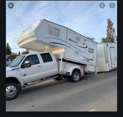

Toddbigboy Truck has it on the Money--just ONE miss calculation of the payload and tongue weight load leads to the camper running your life not you running and enjoying its life. It looks like he didn't calculate the tongue weight loss that needs to be added when adding a camper, it really makes a difference in lowering your available tongue weight. That is one heavy camper for the truck he has with the trailer he has. Looks like his drop leg for the camper was left done also. The rear frame tie down laying on the ground says a lot about the quality of the frame mounted tie downs.

Many people like to ignore payload numbers. Not that a 2500 would suffer this fate with a slide in camper but a 2500 Cummins would be quite overloaded with that camper, let alone the trailer too
Probably what he didn't account for was the extension he used to hook the trailer up, nothing like extra leverage to amplify the trailer tongue weight. What is surprising is that being a dually, should have a payload well into or over the the 5K lbs. mark.
It's a 2012-2016 F450, and I think it's a 15 or 16.
That...should not have happened. That right there, given the truck it is and how it's built (I've been around FAR too many of them), could only happen from unsafely modifying the frame of that truck, or SEVERELY overloading the trailer...because that frame broke, on a truck that is rated to haul 6k in the box and/or 30k+ from the hitch on the back. It just...shouldn't have happened.
Good catch, I just noticed the ten lug wheels but was thinking it was a F-350. Your definitely right about that shouldn't have happened unless the frame was compromised. Even if that was a F-350 it shouldn't have happened.
Unless they tow/haul something other than that slide in and the tag along it would be a stretch to put enough weight in those to hurt the truck.
I mean I could see it happening on a truck that saw nothing but road salt for 20 years, but that truck isn't that old and really looks too clean to have seen that kind of road salt. I suppose it's possible that they consistently overloaded the truck and then bounced it REALLY hard quite often while fully loaded to weaken the frame enough that a car hauler and a truck camper could break it...but even then, those trucks are built to take a lot of abuse.

Meh, without an explanation, the picture is meaningless.
