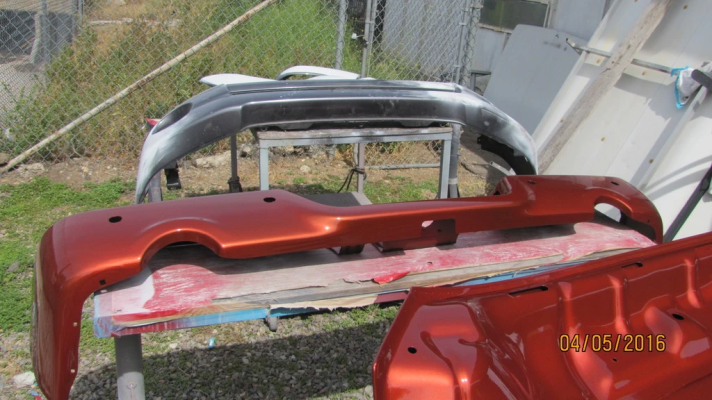

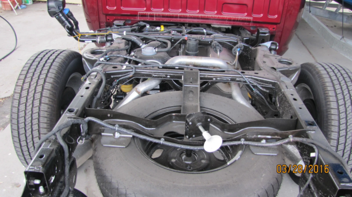

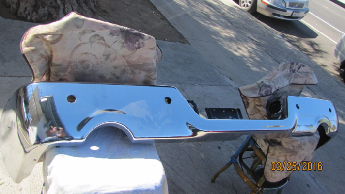

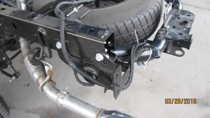

I have the factory dual exhaust bumper, thinking of seeing if I can swap this to the paintable bumper with no cutouts
People are usually looking to add the dual cut-out bumper, but yes either bumper will fit. The available exhaust hanger locations are the same on both dual and single outlets.
Even an HD truck bumper will fit but the trailer 7-pin plug wiring needs to be moved.
