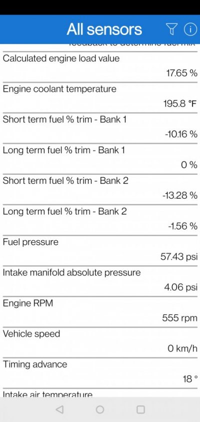

I have been chasing a gremlin for quite some time and wondered if anyone had a similar issue.
The truck with one occupant feels like it is towing a load on acceleration and upon letting off the gas rapidly decelerates as if the brakes are on. Also has the 2-1 shift bump.
No current codes present and serviced the transmission no improvement. Right manifold stud repair just completed and the techs out here cant figure it out.
Just picked up alfaobd and trying to figure it all out and see more of what the truck is doing.
Any insight would be great.
P.S. on one random occasion the truck just magically fixed itself but then reverted back to constipated mode.

No water afr looks good on scan. Just reset adaptives and quick learn for transmission

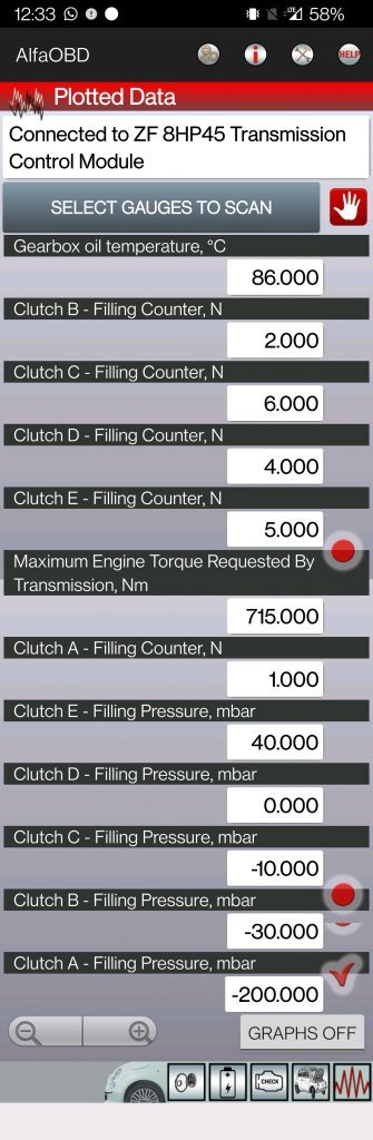

Jack the truck off the ground and check the brakes, wheel bearings, etc. Also check the differential and transfer case.
Dealer checked out ok for diff but replaced front driveshaft and rf wheel bearing and r exhaust manifold. Still a head scratcher. Noted scan of trans fyr

Well its been back at the dealer. Right side LTFT at 0 and Left side at -1.59 and cold tick on startup SMH.
