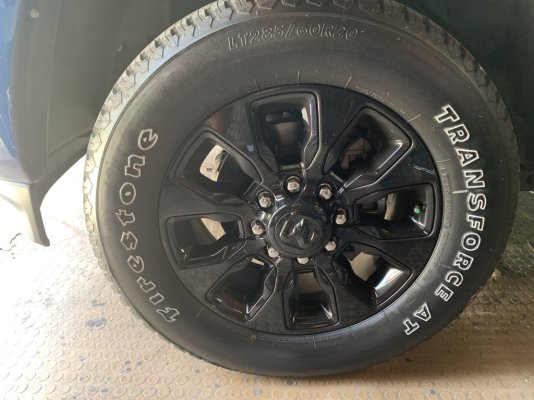

I just bought a 2024 Ram 3500 Limited loaded for towing. I connected our travel trailer up to see how it would tow. When i get passed
40 mph it's like driving a boat. It has E rated tires. They are Firestone Transforce ATLT285/60R20. Has anyone else have a problem with these tires ?

I hated those tires. But, it may not be the tires so much as it is you need some anti-way devices on the hitch.
Tell us more about the trailer, your tire pressures and your hitch setup.

Agree with Maddog. Not enough information.
Those tires royally suck, but shouldn't be "the" issue on a 3500.. Give us the specs on the trailer, and the weight distribution hitch. I've towed my 9800 lb TT behind my 2500 with no WDH and it did ok. You should be doing better than that. If it's swaying, it looks like you may not be set up properly.

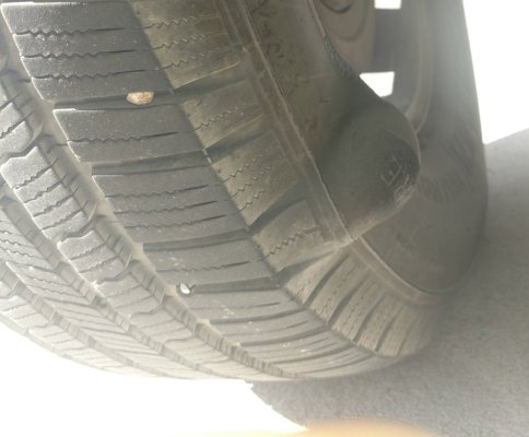

I’ve also had a poor experience with them blowing bubbles in their sidewalls. (I’ve tried to upload a pic of a bubble on the inside of my rear Michelin on my Ram 1500 that looks like a Tennis-Ball is inside it. I was surprised that after I discovered it (purely by accident as I looked under the truck to check if my hidden-key magnetic holder was still in-place)…it held together for almost ten miles tho’ until I could get to a Discount Tire.
They said they’ve seen several of ‘em do that.) This was my 4th or 5th set of Michelin Defenders and I had no trouble like that with the others, although they all were lousy in wet grass.
