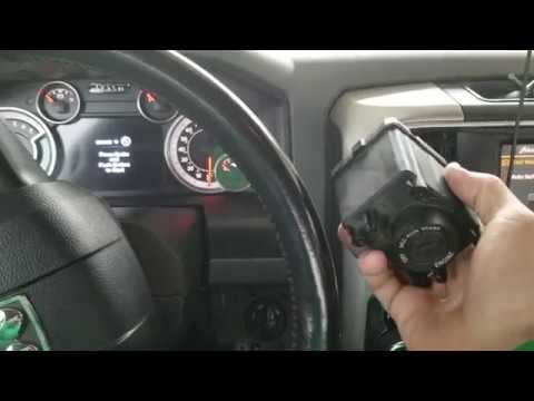

So no codes also helps, one possible cause is win module ignition, the truck "thinks" you shut off the truck so it doesnt toss a code. You can easily bypass the win module and use a cig relay and set up a push button start, you can do it temporary or hide it good and make it permanent, just to help diagnose.
Another thing, there are sensors that protect your engine by shutting it down, a suspect in these cases. However, they usually toss a code when they do so, which leads me to believe bypassing ignition might solve your issue. I'm not 100% on this, the power outage suggests it may be battery related. But this is something to consider.
Here is how to bypass win mod.

Watched the video on the win mod. One difference with my situation is that the dash would be off while the key was stuck in the ignition and wouldn't start. Then 15-30 minutes later. (I'm out side the vehicle on the phone) I hear the truck beeping like I just put the key in the ignition and the dash comes on. I can start the truck and go like nothing happened.

Yes, I hinted at that when I said power outrage, but not every win module will fail the same way. That is a simple way to test ignition, if it fixes it you know all you have to do is replace win module and flash it. Furthermore, you can always have the stuff to bypass in the truck and you will never be stranded for this.
