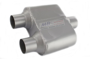

Try this Jones Exhaust Full Boar Race Single Chamber single in dual out, i have had one on my truck for over 2 years with no issues [same as a flowmaster 10] but way cheaper. E Bay for around 40 bucks with shipping.
