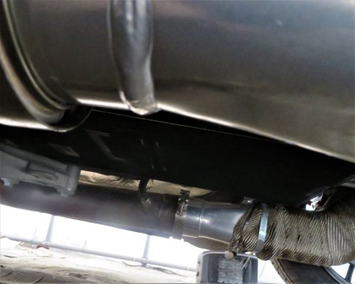

Try wrapping the exhaust system with header wrap
@Wild one is right, wrapping the exhaust pipe, especially the 2' before the muffler, with header wrap will help with the drone if not eliminate it so you can't hear it in the cab anymore. This is an old trick that we use to get rid of the resonance inside the pipe.
I had my headers wrapped and both pipes to the mufflers wrapped to keep as much heat in the pipes as possible,then used the mufflers as a poor mans expansion chamber,but it also cut down on the drone alot.
Not sure how much benefit there was to using the mufflers as an expansion chamber,but i always figured it didn't hurt either ;)
Wrapping the exhaust to cut down on pipe resonance is one of those old school tricks that still works,whether it'll cut his drone down to where it's livable for his ears,is a question that can only be answered if he spends the time to wrap his exhaust system

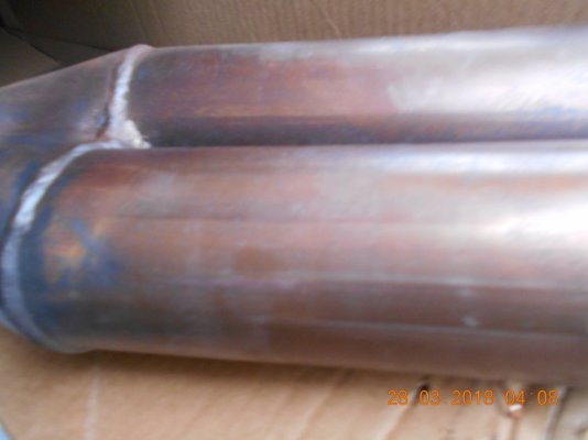

If you have lots of patience you could double wrap the exhaust. This was my JBA midpipe after being double wrapped for about 5 years,and i'm what you might call a bit a n a l when it comes to washing the undersides of my vehicles,so the wrap got soaked at least once or twice a week,lol.
Not even any surface rust .
WOW! Nice, looks practiclly new.
My JBA long tubes went on the truck in the spring of 2015,they were double wrapped,and when i sold the truck awhile ago they were still in pretty decent shape,i figured they still had at least another 7 or 8 years left in them,before they'd need replacing. Double wrapping them also meant i never had the common issue with the steering shaft cooking itself to death,which is a pretty common problem on the trucks with long tubes. I did have JBA ceramic coat them which might have helped with keeping them in decent shape with the wrap.
I did the same thing with the long tubes on the wifes 1320,had them ceramic coated before wrapping them.
