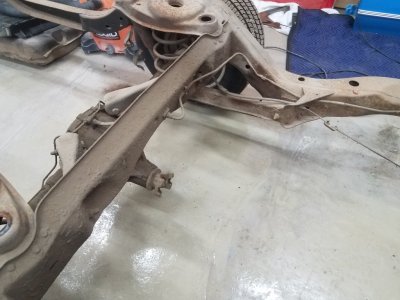

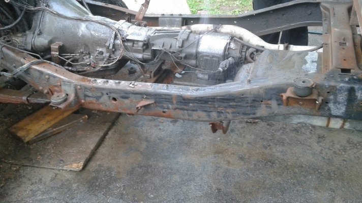

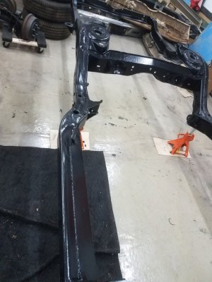

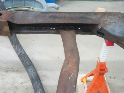

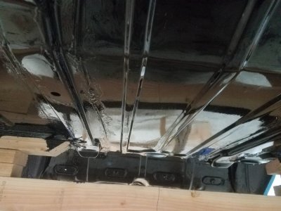

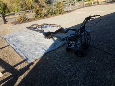

here's a few shots of my chevelle frame, before, after wire brush, after power wash, then por15/frame paint, and then a shot of my floor pan after welding in/seam sealing a new trunk floor also with por15/frame paint.
