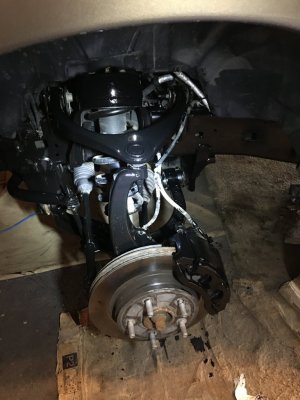

Wear coveralls, this stuff will stay on your skin for many days and eye protection.
I used dollar store brushes 3 inch and 1 inch for the smaller areas.
I painted the por15 then brushed on rust paint (armor coat- brand) as the top coat with separate brush.
Drive up on 4 wheel ramps and pressure wash underneath. It gets it sparkling clean. Start high and work your way down when painting.
Keep it ventilated as this stuff is not great to breathe in or wear a mask with filters. You can do the driveshaft with no issues either. I found the exhaust peeled after a year. I used a gallon of POR15 and a gallon of armor coat as a top coat. I painted all 4 calipers, frame, front drive shafts, UCA, LCA, tie rods, everything except for rotors, springs. I did as much of the undercarriage of the truck and box without removing the tank, etc. I did the rear axle, sway bars, and as much as I could reach. The more you remove, like the front bumper, the easier it will be.
If anything pops into my head I’ll update this.
Once your happy with it, use Krown rust proofing to keep it lasting forever.

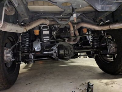

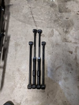

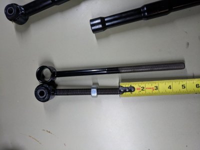

So I finally just threw the longer endlinks on that hellwig sent. Thought it would be a great evening... 90 degrees and 85 percent hunidity. Both ends of the sway bar are close to parallel with the ground now. I just took it for a spin up the neighborhood into two large, open culdesacs and holy hell what a difference. I took both immediate full turn at 20mph, tires screeching and all and there was nearly no body roll. Full disclosure, I was able to unscrew the top of one of the endlinks attached with my fingers, so the comparison may not be 100 percent lol. Made sure to use all the lock nuts this time instead of my own hardware. Pics below. Side by side with the previous endlinks that came with the kit supposedly for a 4-6 inch lift.IMG_20180629_224430.jpg IMG_20180629_231302.jpg IMG_20180629_231321.jpg

Oh, also... I feel like the turning radius was much better, maybe it's because I had much more confidence turning aggressively due to the lack of body roll. My first turn, I did not go full bore at first until I felt the improvement and confidence with the lack of roll.

Damn how long are they now?
I hear make them parallel with the frame and some say the ground.
BTW, with a 6” kit your panhard bar should be in the top hole on that bracket

Not sure how long they are now, but I can measure if you're really interested. I did shorten the new endlinks quite a bit over their max length, probably two inches or so. Hellwig directions said parallel with the ground. Both ends of my bar aren't even now. I tried to even use a level and there was a decent, visible variation. I assume it's because of whatever that ******** powder coater did to my bar. Thanks for the heads up in the panhard bar.

Thanks for the measurement
The top hole on the differential mount is for the 5” coils (I thought that’s what you had)
