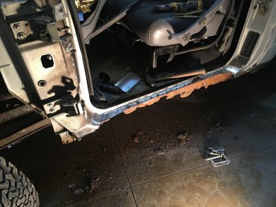

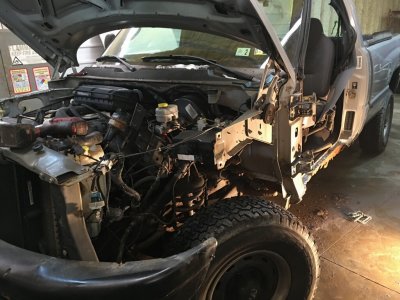

Waiting on the body shop to finish all the rust repair. Next question. My father Had a 2001 std cab long bed. SLT laramie. 360 automatic. This truck was a monster in High school I used to run mustangs with it. No idea what ratio.
