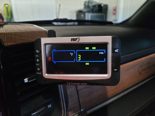

Just wanted to share something I recently learned. This is for those of you who pull a trailer and use an aftermarket TPMS system. I have been installing TST TPMS systems in my various rv's for several years and usually wind up jury rigging the monitor mount by cutting off a portion of the supplied mount that attaches to the monitor and attaching it to a vehicle mount. I recently found out that the hole pattern that TST uses on their monitor is called a 4 Prong Richter Mount. Proclip actually supplies a 4 Prong Richter Adapter with a tilt/swivel feature that will attach to their various bases. It is their part no: 215058 and is called a 4 Prong (Richter) Adapter Plate with Tilt Swivel. I just today installed it in my 2021 Ram Pickup. Picture 1 shows the Proclip Vehicle mount specific to my Ram. Picture 2 shows the Richter Adapter Plate and picture 3 shows the completed installation. For those of you not familiar with Proclip, they feature vehicle mounts that don't require drilling but attach by utilizing seams in the dash or trim. When removed they don't leave evidence that they were even installed. Their website is proclipusa.com.

Thank you for sharing this. I am getting a new-to-me 2019 Longhorn 2500 in about a week and hope to integrate a TPMS for our trailer. This looks like a fairly seamless installation. I was hoping (wishing?) that I could integrate into the truck display, but it looks like that is not possible.
