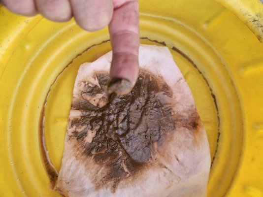

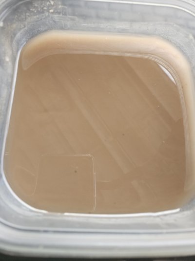

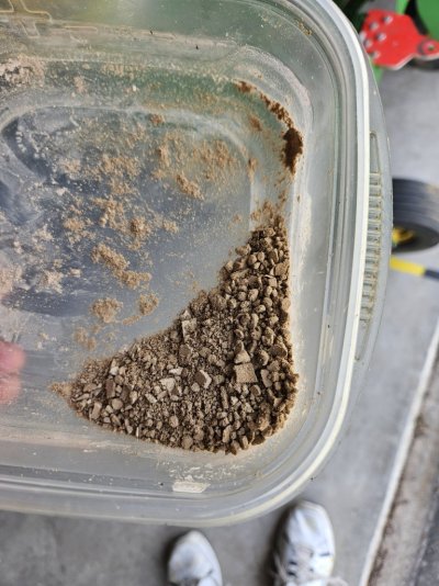

My '08 2500 gasser called for HOAT coolant same as my '03 1500 hemi. The '03 eventually needed a new rad so while at it, did a complete system flush and filled it up with Prestone Universal "All make & model & color" mixed along with 50% distilled water=problem solved. Ran it 70k without any issues or overheating whatsoever. I checked it often to see if I'd notice any sort of deposits or sediments floating around. Result? Clear as water. Did exact same thing with the '08 2500 hemi and same results after 50k. Save yourselves the headache. Do a complete and thurrow flush making sure all the HOAT/OAT crap is out and keep it simple with universal coolant and you'll be fine.
EdGs
Nov 29, 2020
5,632
11,927
FL
The issue with OAT and HOAT is the acids that are there to fight corrosion latch on to/attach each other instead and you get little solid bits in your coolant *and* you make ammonia in your coolant, and I figure we'd all agree that's not a desirable thing to have.
See this TSB filed on the NHSTA site by Chrysler: https://static.nhtsa.gov/odi/tsbs/2012/MC-10216327-9999.pdf
I never was really great with chemistry, but if you're getting an ammonia smell you've probably created...ammonia. :D
Ammonia is NH3, so nitrates are breaking up and the nitrogen atoms are stripping hydrogen atoms from something and then latching on to them. OAT coolants don't have any nitrates. HOATs do. So if you're getting an ammonia smell, then you know the OAT is somehow breaking down the nitrates in the HOAT as it didn't have an of it's own to bring to the party and HOAT didn't start out with an ammonia smell (and neither have pure elemental hydrogen, obviously) That also means other compounds are forming in there, as the rest of the atoms originally attached to those hydrogen and nitrogen atoms didn't disappear and will be latching on to something themselves. Some of those are making whatever the floaty bits are, maybe the stuff people think is casting sand sometimes? I don't have the depth of knowledge to know to that level.
In my case, I know for sure only OAT was used since 28,684 miles, thats all I used.
Not sure where this schizz came from, but it was in there.
