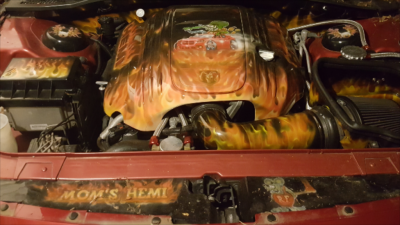

My wife and I had matching (color) Magnum RTs for years.. She still has her "baby" but I ended up moving on. When we first got her bone stock Magnum, she didn't even know what a mod was lol. But once she got the bug.. It was on! We put alot of time into those cars and did alot of group activity.. Shows, drag strip and hanging out wherever.
Her car (now) pictured. We run a Diablo can tune with CAI and exhaust. The tune made a modest gain at the track.. 14s
My Magnum was more slammed and was running a custom tune, headers, cat delete, JBA Exhaust, Crazy Jay Cam, 3000 Stahl, Decked and Ported heads with a Hundy Shot. Was a 12 second grocery getter.
For time being I'm glad to be free of complicated mods. Had I kept as simple as hers, I may still have my old Magnum. Loved that car.
With that said, keep it practical and the love will last.
This is sharp a hell very nice.
