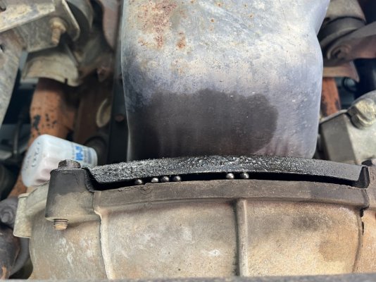

A quick look under the truck revealed that the throwout bearing left the chat in dramatic fashion.
The parts counter guy asked me, “How do you know it’s the throwout bearing?”
The parts guy was convinced after I showed him the image above. So off I went with a replacement clutch kit, including a new pressure plate, friction disk, pilot bearing and throwout bearing.

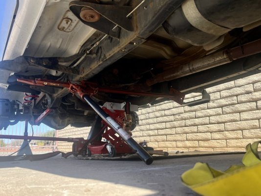

It took a whole day just to get the old clutch out. The cross-member the transmission sits on was not willing to budge after being unbolted… even with the weight of the transmission and transfer case sitting on it. The cross-member laughed at the rubber mallet.
For lack of an OSHA approved technique, I had to use a farm jack to spread the frame rails and work the cross-member out Wile-E-Coyote style, with a lot of heavy iron hanging over my head, and under enormous tension.

I don’t know whether my individual truck had a previous adventure where the frame got bent, or whether Ram engineered the cross member to fit that tightly… but the crossmember was too wide by about two fat thumb-widths.
By the end of Day 2 I had everything put back together, no personal or property injuries, and the truck had a new clutch assembly, new hydraulic ***** & master cylinder, new transmission mount, and as a bonus I identified and fixed a broken vacuum line secretly hiding on top of the transmission.
Another *bonus* is that I thought I had a noisy transmission input shaft bearing, because the NV3500 transmission was noisy in neutral, just idling, without the clutch pedal depressed. In my experience, a dying throwout bearing usually makes noise when you depress the clutch pedal. Well, after replacing the throwout & pilot bearings the truck now idles without any transmission noise.
