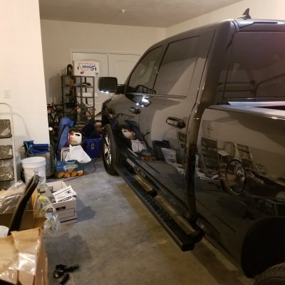

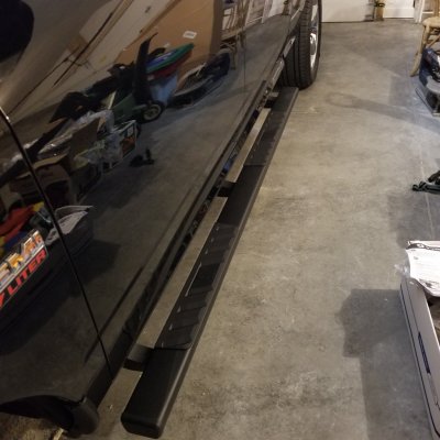

Installed some Tyger running boards so that my wife and kids can climb into the truck. I did a ton of research before buying and landed on these due to these factors: flat vs oval, full length vs just steps at the doors, price efficient, least amount of negative reviews that personally scared me off from other brands, and looks (wanted something without chrome). Link to what I bought. https://www.amazon.com/Tyger-Auto-TG-RS2D40078-2010-2019-Running/dp/B01AH5IYBO
Install Difficulty: 1.5/5 stars
Everything came well packaged. There arent too many different parts. CHECK BRACKETS AGAINST PICTURE FROM PARTS LIST AS THEY ARENT ALL CORRECTLY LABELED. This is the most common negative review I saw so I was prepared. There are interchangeable brackets so I think they just grab by shape and not how they are stamped. The only thing that really took me much time was trying to figure out how to best get the gold mounting bracket lined up inside the sheet metal. After I figured it out the first time it took only a few seconds to line up the second time. I used my finger to hold the gold bracket in place through the upper hole while i attached the bolt through the mounting bracket. Other than that, if you can put something from Ikea together you 100% can do this yourself. Overall from unpacking to finish took 2 hours and 15 minutes to do by myself.
Looks: 6/5 stars. I am super happy with how nice these look.
Will have to see how they hold up over time, but they seem incredibly sturdy. I will be sure to get some better pictures next time I get her out of the garage. I highly recommend this mod from both a function and asthetics perspective.
