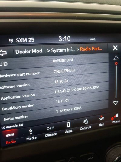

Watkins. Scroll up/down & post a picture of the application version.
Do you have a 'NAV' icon in your APPS menu or on the display (without phone connected)
M² Mods.
Mpgrimm2
Supporting Vendor Navy Badge
Mar 30, 2014
6,588
5,202
SC
2022 Ram 1500 (5th Gen)
5.7L
No, I do not have a nav icon.View attachment 165817
Ok then. Looks like you have the 2018 UAS 4c radio (w/o nav) and are on version 21.9.
The update file I posted ( Post 986. ) should work for you if you want to use it or you can have the dealer do the update to v22.6 referencing TSB 08-016-19_Rev C

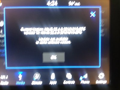

Well I went for it. I downloaded something and am uploading it right now into my truck. fingers crossed.
musicwatkins
Sep 9, 2018
68
26
Michigan
6 cylinder
I got a screen that said download not compatible but, I think it worked. I had my bass setting on -1, now I can crank it to +8 where it used to be pre update. Sound quality is definitely clearer.

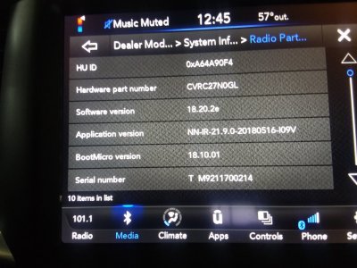

So if we have Nav, will this update not work?
TexNorseman
Oct 3, 2017
222
113
2018 Lonestar Edition with Black Out Package
Here's is my software version on my 8.4 with nav. Guess this is a good version?b830caa6b7ac9cc4db87221d7695eb20.jpg
Sent from my LM-V405 using Tapatalk
TexNorseman
Oct 3, 2017
222
113
That is correct. If you have Nav, this is not the update you are looking for.
Ty for the clarification.
