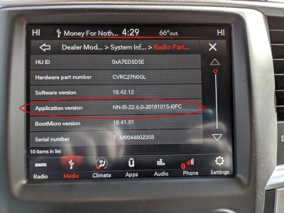

I've had 3 different UAS v21.9 radios in my 18 Laramie CC with factory UAS and Alpine and haven't noticed any of the reported sound quality Issues (usually have bass at +1 ). Fluke or not?
Quick question for you UAS v21.9 folks that reported the poor audio...
Do you have the standard 6 speaker system or the amplified Alpine system?
What is your cab config? 2dr /4dr ?
What is the hardware pn of your radio as reported from within the dealer menu?
ie: CVRC27NOGL (All 3 I've had)

I am the OP of this thread. I had the distorted audio with application version 21.9. I now have undistorted, good sounding stereo with application version 22.6.
I have the standard 6 speaker system. Four door crew cab Big Horn. My hardware part number is CVRC27NOGL.
