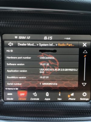

If I have been reading right all the UAQ radios are the same except the mounting brackets. I have one in a 16 challenger that I'm trying to figure out the software numbers. None of the ones you guys posted even come close to mine so hopefully you can shed some light for me. I'll include a pic of the Dealer screen. Thanks

The Panasonic radios are not like the harmons as far as being pretty much universal.the application/firmware are all over the place and almost vehicle platform specific.the only thing I can verify is a pre 18 300/challenger Panasonic will play in a ram but all the functions do not work like some of the menu text is missing and no screen options it's stuck with a chrysler boot screen.and a 19 compass uaq works like it should in a ram.although it's differant. In that you can choose between about 6 vehicles for the nav icon.and I have heard of a Durango Panasonic not even powering up in a 18 ram.I know of couple people that even used 200 ra4s in a ram even though infotainment.com said that wasn'the possible.
