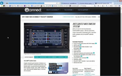

2011 has Uconnect ... according to the application listings on the Uconnect site 2011 was the first year. My radio starts up with the Uconnect splash screen......Below is the system I have in my 2011 Ram Laramie...
yup 2011 was the first year for uconnect, in the cars, it was the 8.4 screens, the trucks had what was called mygig uconnect. it was made primarily by garmin, and had a built in hard drive in the dash. once they switched to the 8.4 in 2013 they dropped the hard drive.
with the mygig system it is possible to update the maps for free by yourself a si used to do i ton my 2012 PW, but there is sparse information and i no longer have any of it book marked.
the new 8.4an system though i have not seen a way to update your maps for free, solely a dealer paid update.
