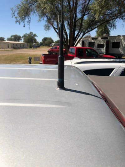

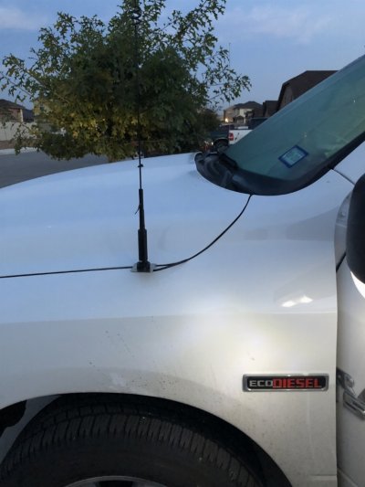

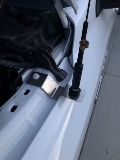

Look at DX engineering, they have a front fender mount that works really well and looks nice. I’ll post some pictures when I go out to my truck. I ran the cable through the driver side door actually. Picking up power from the lighter plug for now until I can figure the best place to pull it for a permanent set up.
For mounting in the cab I would try and go for a detachable head radio, that way you can leave the bulk of the radio under a seat and run a cable to the head.
FYI the lighter plug in the center console is actually supposed to be rated to something like 20 amps which will cover most radios.
Edit: When you say UHF are you talking CB? Or Amateur radio?
Edit 2: Pictures

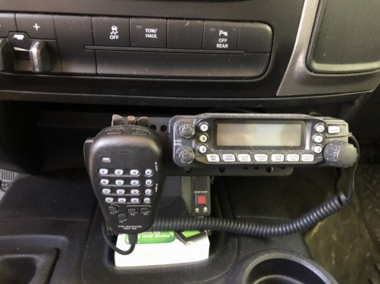

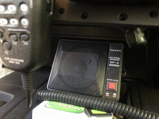

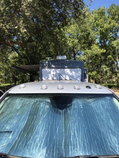

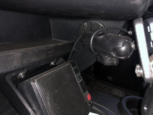

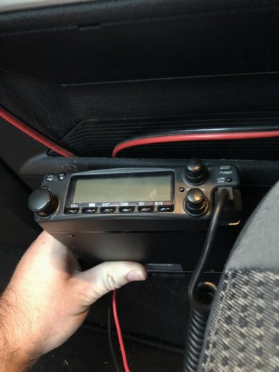

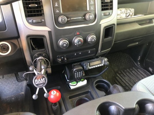

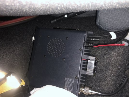

Here is what I did with my Yaesu FT-7800 UHF/VHF Amateur Radio.
26e3c065af76a6bd9a98d94df23000f5.jpg51349a0d6412b1702c6a6aaacde644fb.jpg228dee40854f5425d28627235b2f3279.jpg24cc16c555edc08758899e6397c8fab4.jpg
Main unit of Radio under the rear seat. 834e71881ff877bb0447f3a2baf2e18d.jpg

That looks awesome! I’m a ham as well, looking at a CS 800D for my next install.

I’m leaning towards the ICOM 5100. Where do you have your radio mounted?

Thanks guys. I like the fender mount coming out from the bonnet. That looks the goods.

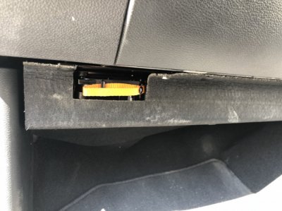

Also I noticed this little orange strap in the footwell of the passenger side, which looks designed to pull. But no idea what it is.
Anyone??

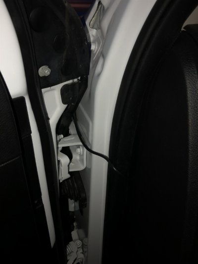

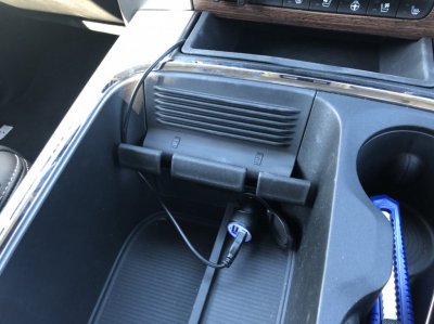

Dash cam is in. Mounted to the HiBeam sensor cover and the cable then runs into the roof lining, behind the drivers side pillar and then into the back of the dash.
I then fed out of the back of the little rubber tray and into the console to grab power. Neat and plug and play.

That is your transmission emergency neutral pull (for lack of knowing the exact name). If the truck ever completely dies or you are in a wreck, tow truck driver can pull that to put it in neutral. Avoids destroying the trans.
I forget you are RHD down there, so had to think for a minute.

Ahh. ****. Would have been nice for the dealer to tell me that one.
I did try and pull but it didn’t seem to want to budge. But I’ll leave it alone I think. Lol
