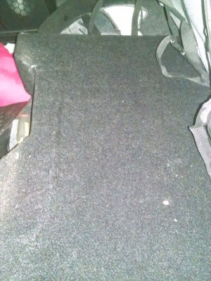

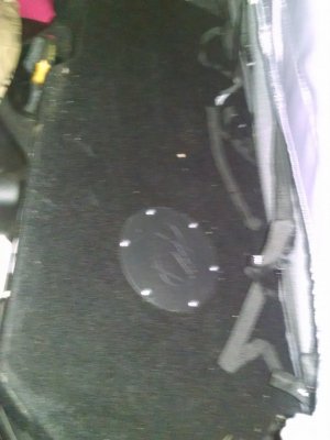

I had to build a custom box (non-ported) for under the driver's side rear seat. It took up the entire driver side and the area over the middle "hump" to get the right box volume.
reek
Nov 23, 2014
1,594
736
Sacramento
2015 RAM 2500 CC 4x4, 72 D100, 73 D100, 01 RAM 2500 field truck
here's some crappy phone pics. it's a near rectangular box with a 10 inch woofer mounted on the under surface, cone sticking out of the box (mounted inside out/backwards) and wired out of phase to keep the sound in phase. That was the only way to make up enough volume in the box and make everything fit. Sounds great.
