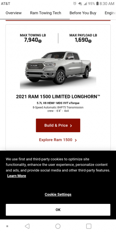

It’s a little dark now but I can check the door sticker to confirm. This is from “MyRam” dashboard which has my VIN on it so I suspect it’s right but I will double check.
Those are the generic numbers. For a tradesman.
Go look at your door jamb.
Bet you are under 1300lbs. Have seen Longhorns under 1100lbs.
You need to rev that Hemi. 2700RPM is not enough.
His numbers are directly from the ram site that lets you look up, by vin, towing and payload capacity.
Yep. And it makes mistakes. He needs to look at his door jamb.
But if you look at the shot. It shows the generic page behind it.
Looks like he did configuration by accident.
He needs to enter a VIN

I did a similar analysis a year or so ago on my '16 Laramie 1500. My GVWR (Gross Vehicle Weight Rating) is 6900 lbs. The online chart said my payload was 1500 lbs. I scaled my truck and it was 5720 lbs with me a full tank of gas.
Soooo...
6900 GVWR
- 5720 Actual = only 1180 lbs of payload
This is quite a difference from the 1500 lbs stated online. I'd weigh your truck to get accurate numbers.
I've seen longhorns in the 900 pound payload area
