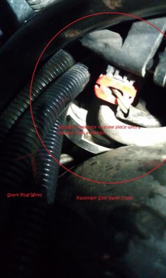

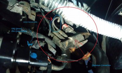

Was changing the Oil Sending Switch and noticed these broken vac lines running to some switch behind the intake manifold on the drivers side of the distributor. I don't know what these lines run to and what the switch/sensor/connector is. My guess is it goes to the 4x4 or cruise control because neither are working properly. There is another broken vacuum line that runs to the passenger side of the distributor to some other switch/sensor/connector with a wire connector as well. Here are a couple of pics.

The one on your left looks like the purge selenoid for your vacum canister for the fuel tank vapor system.
Not sure what the other one is.

I agree that does seem like what it is. Thanks. Guess I need to go buy some vacuum hose now to piece together broken hoses. I will try to get a better pic of the other one but it is in a tight spot.
