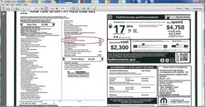

My window sticker shows a $500 upcharge for the 8 speed tranny that's supposed to part of the Sport package. A (silver) truck that I was buying before this one did not have that charge... What gives?

Weird! The sticker on the silver '18 (the one that mysteriously got sold to someone else after I paid for it) doesn't show it. The one I ended up with does have it...

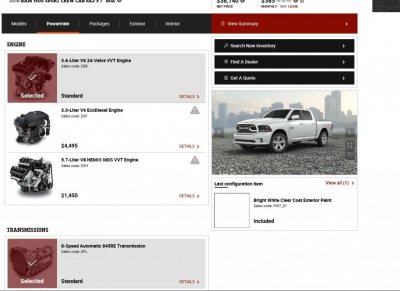

If you go to Ram Trucks, it will let you build a Sport with that tranny and V6...?
