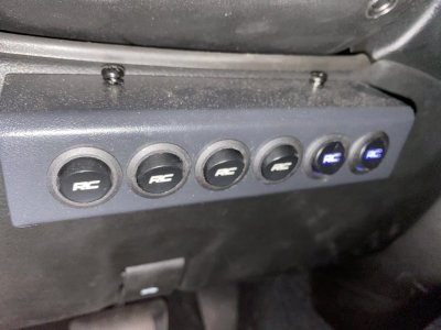

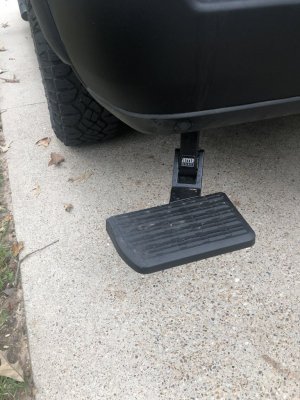

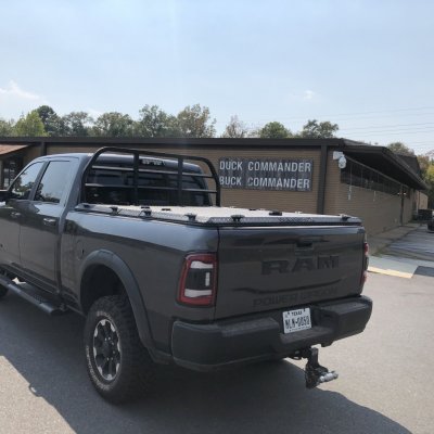

1:stay with 35s if you want to run chains. But you can run 37s without mods on a 19-20
2: @Grand Mesa knows tires tap that resource
3:I’m no help here.
4: @22hemi13 can help here.
5: spod A pillar is sweet. RC is 1/2 the price and keeps it simple but reliable.
6: so Maple and White Knuckle are the most popular I like Randy Ellis design and made my own off their mounting technology but a full truck long step for my needs.
I added some pictures of what I did to my rig to give you ideas.
Good luck on your purchase.
3:I’m no help here.
Thank you!
