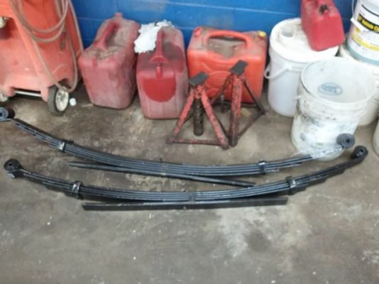

Since I'm Too Busy and got a great deal on install, Tommorrow (FRI) My Toasted Springs that are tired from Previous Owner abuse are finally gonna be sorted and keeping in mind future RCD Lift Kit end state.

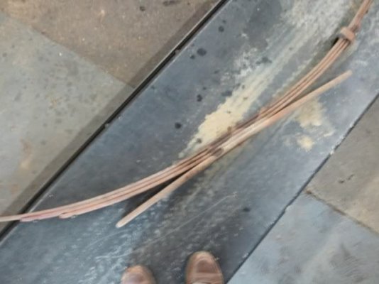

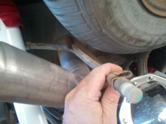

As you can see from the Pics they are tired indeed and the rubber Bushes are cracked and the leafs are even out of line with each other where the bottom 3rd spring meets the overloader Leaf.
IMG]http://i823.photobucket.com/albums/zz152/dodge-ram2/Leaf%20Spring%20Changeout/2010-09-08144317.jpg[/IMG]
So what is being done.
First Install HD springs which are 4 +1 leaf and 2054 Lb Load Rating versis stock 3 + 1 1700 Lb. Part # is HD 3145 BTW. These new springs should add approx 2" of lift and will eliminate the need for future Fab-Tech add a leaf when I get my Lift Kit from PerformanceLifts.com. The leaf springs come with a longer center alignement Bolt.
2nd. I am Picking up 2 x new shackles at the dealer which come with that upper frame bushing and the bolt with blade stopper nut (as I call it) similar to those used as upper Shock fastener.
3rd. Although I would love the Bilstein Option available with future lift-kit purchase I wanna keep the freight cost down so I am Having a Pair of Rancho RS5000's installed with Red Boots.
I want my rear suspension to be in good order when I do my gears in the next few months and plan on removing Chrome diff cvr (last pic above) and adding a Mopar Orange painted one with mopar Chrome Bolts and finish it off with Helwig sway Bar.
This weekend I will post up pics of the finished job and fingers crossed there are no snags as it is a pretty straightforward procedure.

Just a couple quick pics of the install.
Old springs removed.
New HD Springs.
Installed. Notice the useless application of the plastisc Tie wrap onto the Rancho Shock (I told em off about that ... Fkn Morons thats why i do **** myself!!)
Since this is a Western Cdn Truck all the 7 year old fasteners removed very easily without any aids (heat/Torches) other than a quick shot of LW for good measure and hence the Torx spring bolts were re-used w/an xtra 5 Ft lbs applied. They had originally charged me 40 bucks for new bolts, so since the CST U Bolts I provided where a tad long and will need to be cut off (is really my fault) I got-em to agree that I would come back in a week for them to cut em off and do a retorque on everything and we'd be square.
Road test, WOW an awesome soft-smooth ridin Truck and I mean its noticable/Cadillac.
I also gained a full 2 inches of rear lift to go with my current 2 inch Ready-lift keys.
I will remeasure everything and tweak the adjustement. So Ya I'm Lifted (sorta) and got me back just enough Rake to keep me happy.
More/better Pics to Follow: Wait Out as I have been handed a list of house chores. Later Guys.

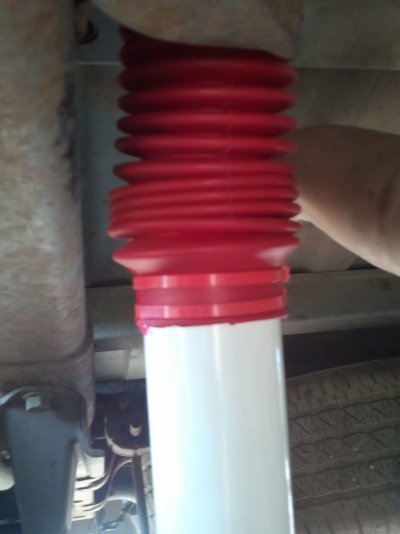

Final Update with Pics: Why I check their work...First Fckup was allowing the nut tab on the upper shock bolt cut into the boot and tighten against the shock.
Fixed (Tiny Hole in the boot (FCK).
Again liked I called it...Useless...$20 Dollar an hour Mechanics.. [QUOTEInstalled. Notice the useless application of the plastisc Tie wrap onto the Rancho Shock (I told em off about that ... Fkn Morons thats why i do **** myself!!)
][/QUOTE]
Yep I was right.....So anyho the Tie wraps fixed and boot correctly positioned.

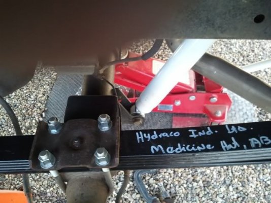

Next Line up the U-bolts, One per side ended up not to be flush to the spring-mount-on diff housing (another fk-up).
Also pissed that 2 of the U-Bolts bolts where over torqued at 135 and 145 lbs (Spec is 110) and that is why the square top plate, was a tad twisted, the u-bolts out of line on the housing and the extra threaded shafts bent, a fkn nightmnare, so they were obviously torqued using a spanner because I've yet to see a 4-6 inch deep socket in anyones tool-box!
U-bolts re-aligned, proper 110 lb torque applied to all (after excess cut off and trimmed).
Filed and shamphered the cut-off bolts & Touched up all the bare spots on the springs where the girly-men shippers dragged the springs accross the floor and also covered up the white Hydraco Distributers writing on both sides with Black enamel.
