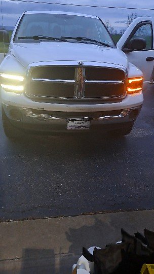

Finally replace the headlights again. This time I used Alpha Rex. I have a video of them on my phone and stored on my computer that play. For some reason it is not listed on either when I try to post.
