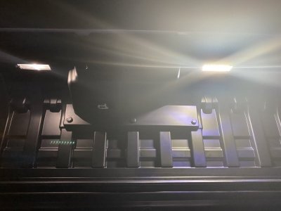

I love my truck(s). Why? Because they are so easy to upgrade and add things on. Some things are easier than others. Here's one that's a <5 min upgrade.
When I first opened the RAMBOX on my new 2020 Laramie Longhorn, the lights I thought were pretty darn good for an "accessory" light. Well, shopping through Amazon I ran across these:
https://smile.amazon.com/gp/product/B082PHNXSL
Stated they had "3 times the brightness" of OEM. Yeah, right....
First of all, these have to be the easiest lights I've ever replaced on any vehicle in my life. No tools. Really. No kidding, no tools at all. Just a flip of a keeper latch, a plug and click in the new ones. Super simple. In the pic below, the old light is on the left, the new one on the right.
img_3073-jpeg.205472
And... wow! Ok, not quite "3 times" the brightness, but at least double. Far more than any upgrade to a light in a vehicle I've seen before. My previous light upgrade story was putting LED backup lights on a Silverado that helped backup in the dark. But these are far more of an upgrade to the amount of light usable in a space.
Oh, and for those that don't know if the light turns off automatically when the lid closes...
img-3074-1-gif.205473

Thanks for posting this. I just ordered the last two sets they had for the two rambox trucks in my household.
I was pretty sure the lights turned off when you close the lid, but thanks for confirming...LOL. Kind of like the refrigerator light huh? :happy107:

i am also looking to change to led light. I have a 2500 2020 limited. i Ordered a set.
when it arrived, it didn’t fit. The main reason I noticed is that the lights on my rambox are on the sides. And not con the cover.
i wasnr aware that this could happen.

Reading the Amazon reviews, Saariko's experience is mirrored by many other HD Rambox owners. These only work in the 1500's.

Just ordered these a few days ago for my 19 Laramie Longhorn Ram Box and installed them this morning. Gotta say these are way better! Be warned the pins inside the light housing are thin and bend easily. I had to spread mine open about 1 to 2 mm to get them to plug in. The pins are not set at the same distance apart as the OEM ones so be careful. Once it gets dark tonight I’ll go check them out to see how much brighter they really are.
