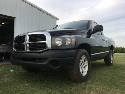

Over the summer I had a similar idea, I was gonna get both my bumpers bedlined. I ended up buying a primed sport bumper cover off amazon for like $150 or so and got that paint matched. Bumper cover was just about a bolt on swap lol
This is the regular bumper with plastidip on it. Bumpers were both painted really crappily before I bought it
Then this is with a sport bumper cover (and a paint matched grill as well lol)

I figure you could paint that piece. Sanding it down might help with adhesion and making a smoother finish.
I had no idea the sport bumper was just a snap on cover. That's definitely the route I'm going. Looks good, and thanks!
