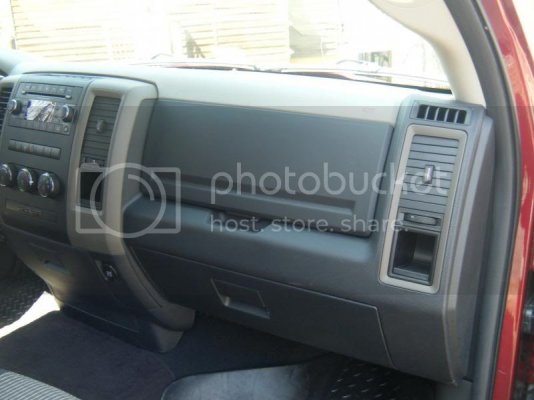

Well, it's finally nice outside so time for a little upgrade. I went a slightly different route than some with my 2012 Express. I wanted to have a Dark Slate upper box, not the lighter upper dash color. Everything went smooth as could be.

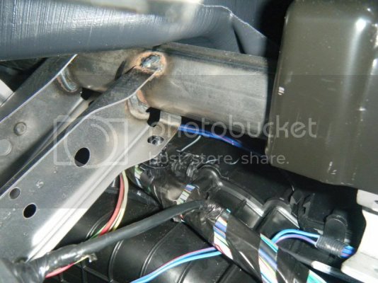

As soon as I took it apart, I lowered the wiring harness. As soon as I did, the switch light plug was there

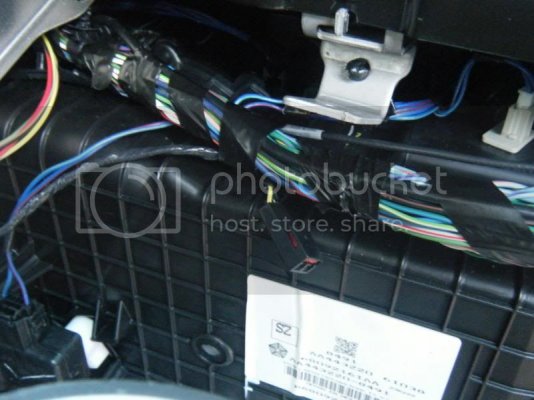

After looking at the U Connect box (to the right of the upper box opening, on the hinge pillar), I saw that there was a plug in the smaller opening, so I was pre-wired. I found the upper glove box end of the harness to the left side closest to the center of the dash. It was tucked under these braces, just kinda hanging back there.
The final product

That looks good Mutt, nice work. Could you add a pic of it open too?

Once you have the upper bin out, you will see the big wiring harness right in front of you. Release a few clips so the harness will drop down a little. VERY CAREFULLY trim back/cut some of the tape that is wrapped around the harness. Mine was right under the tape.
Do keep something in mind when looking for things like this. Things like wiring harnesses are put together by multiple shifts in different factories. I would not expect them all to be assembled in one exact fashion. Kinda like when you open a package of hotdog rolls, the twist tie may be put on by a right handed person OR a left handed person.
Just take your time.. it's in there somewhere
