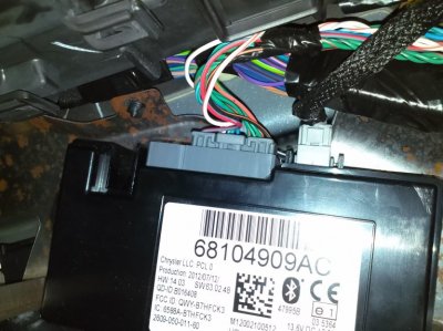

Hi guys. To check if your car has that usb port remove glove box and look to the right.At the wall there will be uconnect control unit with one big 15-20 pin connector and if you have usb cable there will by right by that 15-20 pin conn. another small black wire with small connector connected to uconnect control module. If you have both cables follow D Schroeder instructions.Get good flash light and look between those 2 metal bars/brackets.You will find that usb connector,you may have to fish for it with something like i did.
One of the picture is showing that cable at the uconnect side and the other is showing other side of that usb cable/you can see my usb extension cable connected to it/. Good luck.
