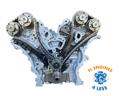

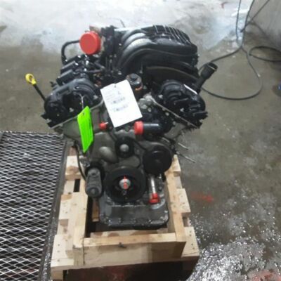

Plenty of options for that truck.
Used:
Rebuilt:
