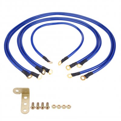

@Oliver Closehauf ... I am more or less.
The old grounds were on the valve cover studs... Can see about 1/2" of what's left of the braided straps. Diagram I saw showed one at the back on the block as well but not found that yet.
Instead of that woven/braided grounding straps, trying to figure out lengths and probably buying ring terminals etc... I bought a ground kit for cheap off Amazon. Thick, nice flexible silicone coated.
Plan is to run one from the passenger side valve cover stud to the driver side valve cover stud, and from there to the frame on the same bolt where the negative terminal connects for ground.
One of the cables I'll run from the + of the battery to the + of the alternator.
That leaves 1 extra cable... Which will go to the block if I find a good spot. Any suggestions?
