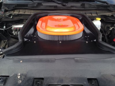

Beauty cover
This one.

Did you use the supplied wing as well? I did not and I didn't cut and move my horn bracket. I am going to remove this beauty cover at some point when it's not so cold and clean the edges up and maybe even bolt it to the Vararam. I'm thinking that my cause unneeded turbulence.
Looking back I wouldn't have remove any material I would have only cut the beauty shield to get the needed flexibility to slide the Vararam under it.
Has anyone used a heat gun on this material to see if you can form it at all? The stock "beauty cover" material?

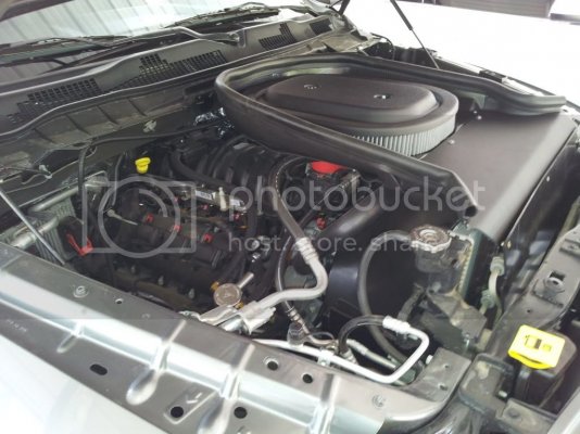

Yea that's the cover I was talking about..Yea I used the supplied wing that comes from vararam because the air that feeds the vararam comes from the grill area.If you have the rubber seal on the hood lip like mine does than the vararam isn't getting any air over that beauty panel,And if you aren't using the wing that vararam sends,Then the air from the grill area is just going straight through to your radiator instead of hittin the vararam wing and up into the filter..
Yea I had to trim and clean up my beauty panel so the air had a clear path up the vararam wing.I sent mine back to vararam as I felt no difference on my truck ,But now that I have a tune for my 13' sport I'm gonna order another 1.

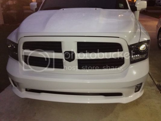

If you look at this pic you will see what I'm talking about with the seal under the hood lip sealing the hood to the grille..

ArticRodz you have your supplied wing mounted on top of the Vararam? How did you bolt them together? The supplied wing I got had the nuts attached to the wing and you had to put the screws threw the Vararam into the wing to attach.
As far as a seal is concerned there is no seal between my hood and grille so air flows strait across my beauty shield into my Vararam and the wing hung down behind my radiator not really doing much.
I feel like it's getting tons more air flow, cold outside airflow like this. But that's what makes modding our trucks our own.

as far as that seal thing between the hood and grill, i think its way to thin to offer any good air flow from removing it. I could be wrong though.

Yea I thought of pulling the seal when I get another vararam..And you are right man as long as you are happy that's all that matters!
