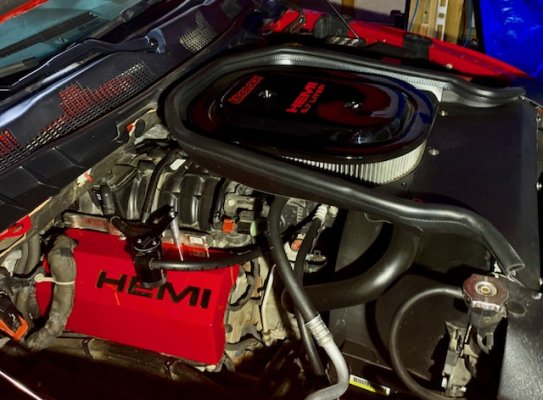

True..but it does keep the air temp under the hood cooler if fresh air is blowing through there IMO...and many on the forum have gone to the 6.4 intake mod for the same reason for air flow..and don't forget the air that used to get trapped into the enclosed air box is now free to further cool the under hood temp !!..and the eye candy is nice..my truck is a piece of art to me..maybe not to others but that', their choice as always..cheersIMG_0978.jpg

Those covers aren't doing your coils any good Dave.Heat and electrical components don't go hand in hand,and those covers are going to keep your coils hot.Your catch can isn't in the best spot either,you want it where it's cooler,like mounted to the rad or fender

Hmm did not know that. I will move the catch can.. gonna have to get some mounting bracket and extra hose I would assume…the covers for now get a good flow of air due to the removal of the OEM air box.. hence the openings normally directing air into the box just allow air to flow into the bay and keep temps down throughout ..off to my mechanic shop and see what he will charge..no long trips planned until Spring so that helps.. thanks Rick… just an aside… re LT’s do you still dabble with installs of LTs or is that a thing of the past?

When you park it,is when the coils get the most amount of radiated heat. Not really,as i only have my driveway these days to work on vehicles now Dave. I'm going on 64 now,so my days of working on other peoples vehicles is coming to an end,lol
