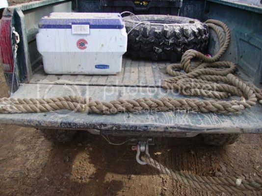

Some people also like to use big rope for recovery which is fine too, so here is what you need to know. How to make an eye splice, and the ropes strength. A knot reduces breaking strength by 40% while a splice retains 95% of the ropes strength. Most people say the rope will break before the eye splice will come apart.
Here is a picture of the splice, literature will follow.

Finished product tested.
