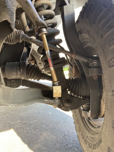

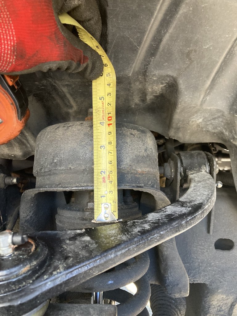

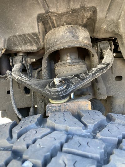

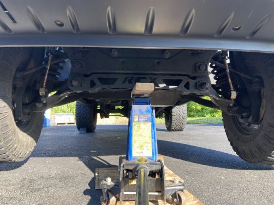

Pics of 4" strut spacer and suspension at full droop.

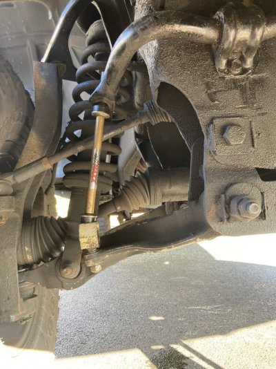

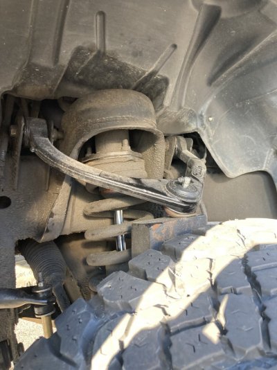

Couple more

The top hat spacers look A Lot like the 6” kit spacers. Measure your tire for actual height so I can do a little math

@smoothee Your truck is a regular cab so the clip on your billsteins in position 4 is netting you 2". I would lower them to the lowest notch and that will net you .8" for starters. While you have the front end apart inspect your half shafts, front diff drop brackets, etc. and DO NOT! tighten any bolts until the truck is sitting back on its wheels.(Under its own weight) I would even loosen the lower control arm alignment bolts just to ensure none of the bushings are binding and youll need an alignment anyway. Pull apart the coils and make sure the struts are working as they should, compress them and make sure you dont hear or see any oil coming out. Dont forget to mark indexing points so you can clock everything back to the way it was. Follow the torque specs pinned at the top of the 4th gen lifted section and the BDS instructions
