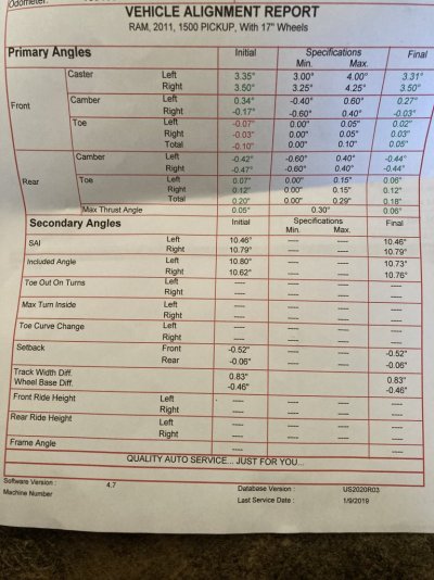

I apologize in advance for the length of this but I'm at my witts end here and don't even enjoy driving my truck anymore. This has been a long ongoing issue, that I will say started years after I installed my 4" lift so I can't blame it directly on that although it may have contributed.
The main thing I'm finding right now is the truck hits bumps very hard, almost feels like the front end is bottoming out and the steering wheel wants to come out on my hands. And at highway speeds when I hit a bridge joint it feels like the front tires nearly leave the pavement. I've had an alignment and wheel balancing done yesterday and the truck drives straight with no vibrations or anything otherwise. Steering feels nice and tight.
I used to be feel it more in the rear too, but not as bad since upgrading everything to Core and Hellwig sway bar and BDS relocation brackets. I did blow through a couple of sets of Fox and Bilstein rear shocks which I couldn't explain, truck only has 65k miles. There's still some shimmy there though.
I've checked everything over myself (and do my own work) and I've had the truck to several shops and none of them could find anything out of the originary. Several alignments and wheel balancing. I've played around with tire pressure, right now sitting at 30psi on my D rated Duratracs. This was happening before with my Toyo's as well though so I can't confidently blame it on the tires.
I swapped my bilstein 5100's for 6112's, added SuspensionMaxx sway bar links, replaced wheel bearings, lower and upper ball joints, tie rod ends, lower steering intermediate shaft, etc. I don't have any noises or clunks anywhere.
The weirdest thing to me is when I replace a failed part the issue goes away for a very short time until the new part is broken in. Eg. I just replaced the upper control arms last week and the issue pretty much disappeared for a few days. I could drive over washboards and hardly feel anything at all. Same thing happened when I replaced my LCA's, and steering shaft (which was shot). It rode beautifully for about a month. It's almost like there's still an underlying issue here that the new parts just seem to mask for a short time. I don't get it.
Does anyone have any suggestions? I'm ready to light a match lol. I don't expect it to ride like a Caddy especially being a single cab, but I know what it has rode like in the past. Also does this look like a quality alignment job?
I appreciate it!

The alignment could be better but it's not the root cause of the the issue. 6112's should not ride that hard even at max. So could be something binding in your suspension. I'm clueless cause our setups are not really that complicated to troublehoot.
measure the gap between the top of your tires and your fender
then Lift your front and put a couple of jacks under the frame, then let the front droop in the air
Measure tha gap again and post the delta.
See is something is binding, looking weird.
Now go practice some 4x4 on something where you can ride your front driver and front passenger tire up. one side at at time. see if something is binding, could be tire ramps for example, i just do it on rocks cause they don't move :)
View attachment 463639Untitled by RAM RSM, on Flickr
The 6112's are only set over an inch and the 5100's before that only 1.4". I drove across the country 7 years ago, not long after having the lift installed and it drove just fine. Everything else stock. I even remember my buddy saying how good the truck rode for having a lift. Now when anyone drives with me they always comment how rough it is.
And I agree about the suspension shouldn't be too hard to troubleshoot. What I don't get is why it would be fine for a few days to a few months and then revert right back. And what I mean by fine is that it just skips over any bumps/ruts without feeling it. Whereas now it feels like it dips in every imperfection and just absorbs it. After I replaced the lower intermediate steering shaft the truck rode great for about 6k miles (also around the time I installed the 6112's). I've never noticed anything binding, but I will get measurements in the next few days to be sure. And I'm jealous of all those trails around you man!

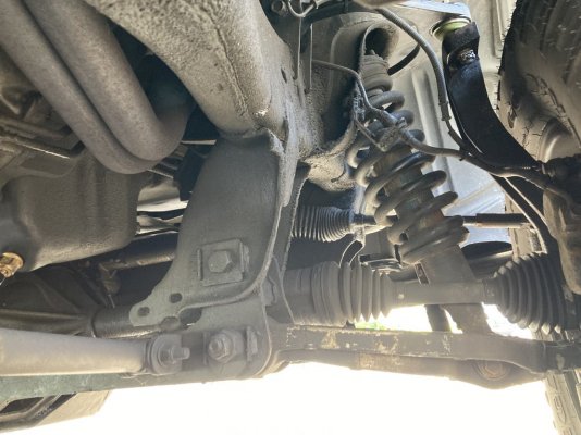

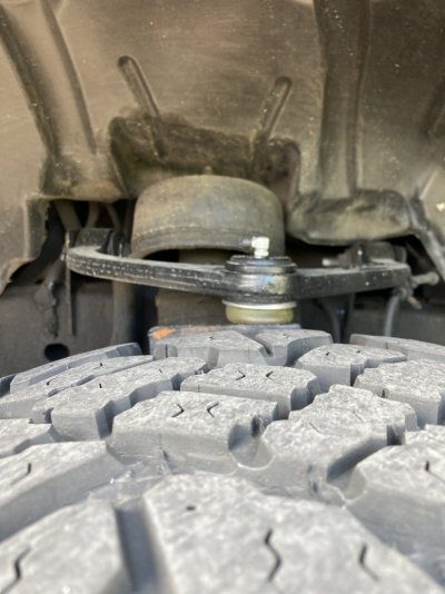

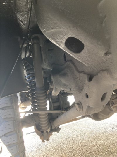

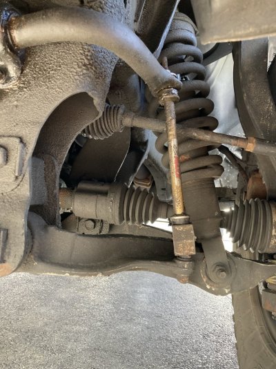

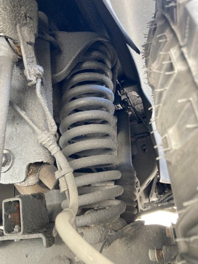

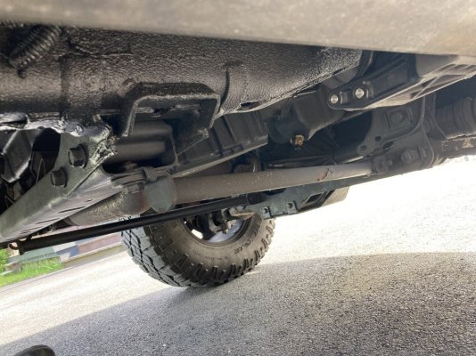

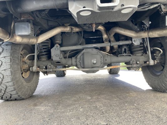

A few pics

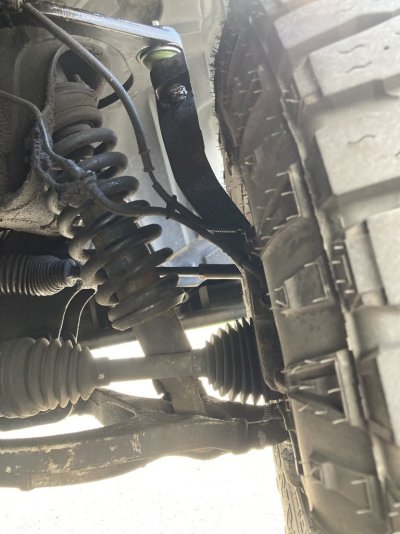

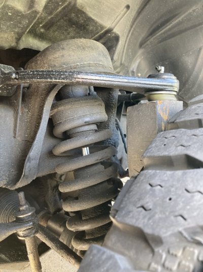

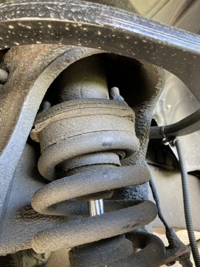

Few more

Don't know if it's pic angles but it seems the bushings on those SPmaxx links are getting crushed. Doubt it has anything to do with your issue though, just a thought those bushings may not last very long that way. they're not rubber like the factory they don't need that much compression. back off the nuts.
I don't see your sway bar angle, how does it look currently ?
As it was said, remove the sway bar and see how she rides.
