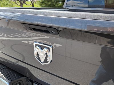

303 is good for just about anything, BUT, you will want to do a couple things with it:
  1. Always spray it on a sponge, microfiber applicator, or a small microfiber towel FIRST, then wipe it on. Using the sprayer is just asking for streaks on you interior glass, or on your paintwork etc. on the exterior. You want 303 to go precisely where you need it, and nowhere else.
  2. ALWAYS buff it off after letting it sit for about 10 minutes with a clean dry microfiber towel. You want to rub the hell out of it as if you are trying to remove it all (don't worry, it will stay behind). Any extra 303 that isn't sufficiently buffed off, especially on exterior trim, tires, etc. will streak and run like mad all over your paintwork, wheels, etc. when your vehicle gets any rain or even light dew on it.
I didn't know this at first and tried just wiping on a nice "thin" coating of 303 and the first time my truck got wet it ran down the sides of my bed and left streaks. Example:
Lastly, 303 is more of a "dressing" than a sealant or long-term protection. It's also water-based. This means on the exterior at least, you're going to have to reapply at least monthly or more if you live somewhere where it rains.
