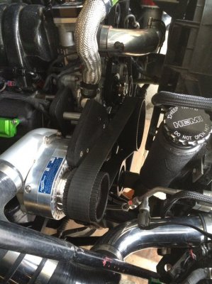

Oh, I'm fully aware you can make anything fit, I offer my F-1A cog driven Ram as proof; had to design and build it all myself because the procharger bracket sucks when you want to make real power. It's not nearly V-21 power level but it's all designed and built now to take anything up to a F-2 without needing to modify the bracket, I just need to figure out what I'm doing for a new engine before I upgrade blowers again. Awesome looking setup BTW, I'd love to go that big one day.

With all the room on the passenger side of the engine bay once you remove the OEM I take there's a ton of room, hence the ProCharger setup. There can't be that much difference between the "snails" and plumbing set up?
Mounting bolt pattern, pulley offset, angle of the body for proper oiling, weight of the head unit, belt routing, and amount of belt wrap required for traction. There's lots of things that need to be considered and that's not getting any of the 3 dimensional geometry when you start factoring in plate flex through the RPM range.
Exactly! "One size fits all" doesn't always apply in the modding world. Even in your case you went with a custom setup rather than a kit. And I know what you mean about pushing things. The Vortech Jeep jackshaft setup wasn't intended for high power applications. Though it was bolt replaceable from V-3 to V-2. That's just mounting. I found ~16 psi with the V-2 was all the serp belt could take. And the cog belt would shred before 60 mph. Replaced the 20mm cog with a 30mm, and it's still the original cog belt. Never could hurt it. And I tried! ;) Would've had to go with a YSi style 50mm cog setup to solve the serp issue. I doubt I'll get bored with the V-21 anytime soon, but at least I won't have to worry about belts, alignment, side load on the crank bearing, etc. anymore. And if I do get bored, I can unbolt the V-21 and bolt a V-28 right in place. But I'd have to upgrade the fuel system again. Always something right?
