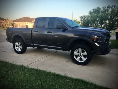

I wish I did a before pic prior to the Zone 1.5” body lift. But in combination with the Bilsteins set at 2.8 up front I’ve got the “poor man’s” 4”+ lift. I could have fit 35s before, but even now 35s look like they would have more than plenty of room in the wheel wells.
And a BL is cheap comparatively speaking to a full on 6”+ suspension lift, not including any cutting, welding, modifying or fabricating in order to make the suspension geometry legit nor keeping things from potentially breaking or prematurely wearing out. Plus, if you have all the right tools, an afternoon and some beer you can do it in your driveway . . . and I learned a thing or two while getting intimately familiar with the undercarriage of my truck. A buddy helping makes it even easier.

35s look better with some space so it looks like a 4x4 vs a stuffed 2wd to me . GIjoe2010 that looks fine to me Only thing that I could think of to look even better is 35s on a 17" wheel only because I like the taller sidewall and the ride it gives over 20s :favorites13: Killeen TX sounds familiar . My son came home March after a few years at FT. Hood playing with Patriot missiles.

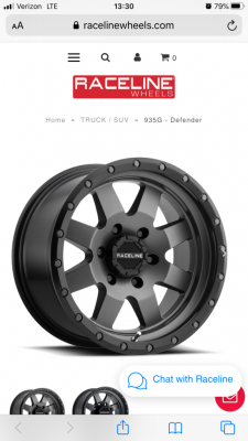

The plan (once there’s a bit more $$$) is Racelines in 18x9 -12 and 35s. Should look killer.
