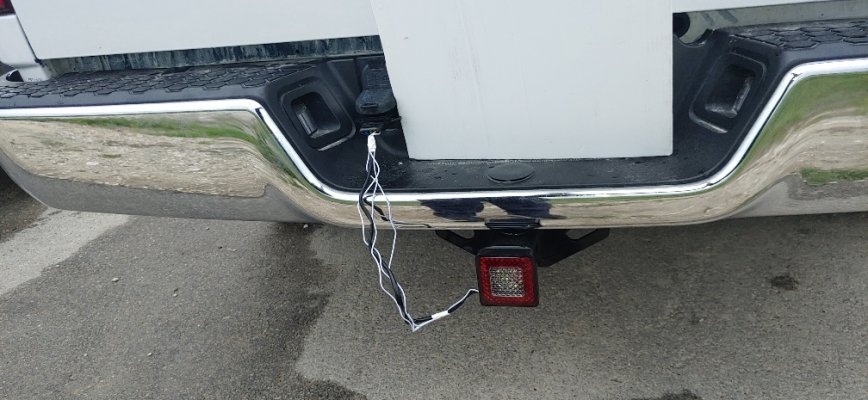

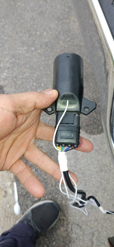

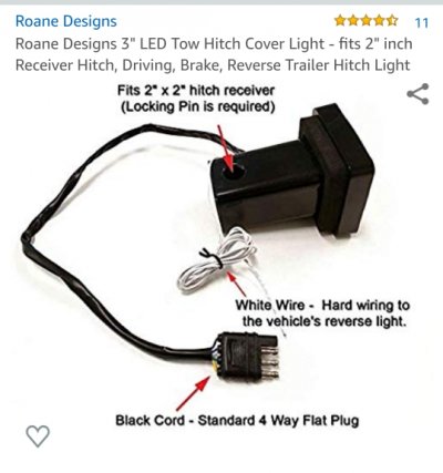

So I bought hitch light. I can, but don't want to splice into my truck wires. How can I make my trailer connection into two, so I can plug wires behind bumper to keep wires hidden?2a35cfd30f003a023128178c22213218.jpgfebd392b250d65eabf02a735a7403e60.jpgc705234ee95bda36b57ee391de9a5baf.jpg96afe79e9b4f7b44e640ba3f2ea1b362.jpg

I bought a Ram hitch light. The cord goes through the hitch shaft and under the truck, I have an “T” harness that keeps my bumper light plug stock while allowing for the hitch light to attach under the truck. The extra length is wrapped around the frame and after 34,000 miles... no shredding, pinching or wearing. I forgot where I got it but it’s called an “T tail light harness.” Good Luck!

asmentioned, by an T adapter, run your hitch light wires thru your hitch reciever to the T adapter adn nothing will be seen.
