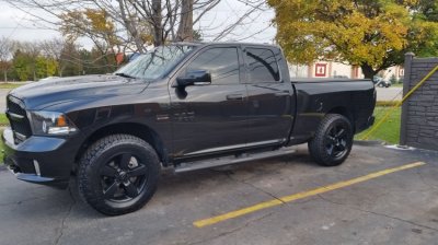

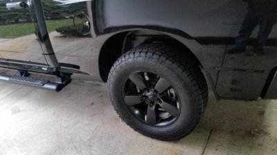

Pretty sure your stock wheels are 20x9 ... I also have a 2016 Black Out Express and that's what I have. I don't have a lift, my front is leveled at 2.1" I'm running Nitto Terra Grapplers G2 285/65R20 on them.

Thanks Bud, tires look great. Definately an upgrade to the stock Goodyears. You have the same 8" rims I do & they limit tire selection. At least your tires fall between the 8" through 10" rim width but a lot of people are using tires meant for 9"x11" rim width without even knowing they're 8"s. Probably very unsafe

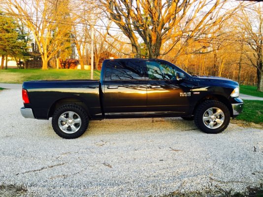

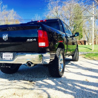

35x12.50 on your same rims. Mine just are the chrome clad version

those do not look like 35x12.5"
